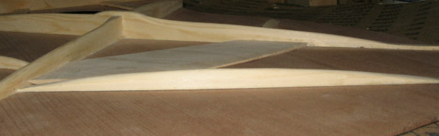

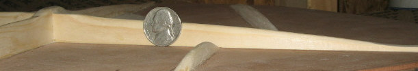

I just finished a redwood parlor a couple of months ago. It was my third, so take this with a grain of salt, but here is what I learned:
The top needs to be thick enough in the bridge area to resist the twisting of the bridge caused by string pull. In my attempt to achieve the perfect finish I sanded the top back to bare wood a couple of times and I didn’t realize how quickly the redwood sanded. As a result, my top is really thin (I even cracked it during French polishing), and I can see where the bridge is distorting the top. The braces are holding firm, but the top is distorting. I had to put in another brace behind the bridge to get it to keep it from imploding. It is not seen in these pics, but is another tone bar that runs from the bridge plate to meet the normal tone bar. My top seems to be stable now, but I’ve got a lot of imprinting. As a result of this experience, the next time I’ll keep the center of the top a normal thickness and only thin the outer edges of the top. Also vitally important that the lower edges of my bridge don't fall over the x- braces, but are instead a little aft. This contributes greatly to the top's distortion.
My bracing for this top was ? wide. Here are a couple of pics.
